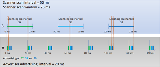

Regarding BLE scan parameter settings
1. Setting the IWindow value smaller than Interval will save power.
2. Setting the Interval and Window values ​​to the same will increase the chances of scanning and being able to connect.
Please let me know if there are any other ideas for setting the Interval and Window values.
