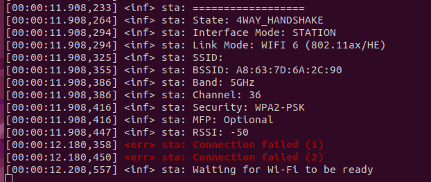

In the nRF7002, when the correct SSID is provided but an incorrect password is entered, the Wi-Fi callback function handle_wifi_connect_result sets context.connected to true
We are using SDK v2.6.1 for our application, along with the Fanstel module WT02C40C.
Internet connectivity is provided to the WT02C40C module via a hotspot, with CONFIG_STA_KEY_MGMT_WPA2 set for security.
However, when the correct SSID is provided but an incorrect password is entered, the Wi-Fi callback function handle_wifi_connect_result sets context.connected to true.
please provide the solution for this.

static void handle_wifi_connect_result(struct net_mgmt_event_callback *cb)
	const struct wifi_status *status =
		(const struct wifi_status *) cb->info;
	if (context.connected) {
		return;
	if (status->status) {
		LOG_ERR("Connection failed (%d)", status->status);
	} else {
		LOG_INF("Connected");
		context.connected = true;
		Wifi_Connected = 1;
		gpio_pin_set_dt(&wifiled,0);
	context.connect_result = true;
