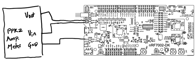

Let me show you the following results. Each result has a raw diagram of the PPK connection in order to show the measurement connection:
1. Test 1: Firmware loaded in the nRF7002DK that uses VDD at 1.8V (for the nRF5340) and VBAT (for the nRF7002 chip) at 3.3V. Here are presented separate consumption graphics with the PPK2 following the instructions of the Current Measurements on nRF7002DK.

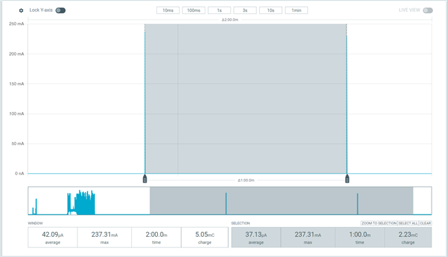

    And of course. I loaded the Wi-Fi: Shell example with nRF Connect SDK v2.7.0, on the nRF7002DK here are the results measuring the current drawn by the nRF7002 chip. I followed the exact PPK2 connection and configuration mode as Source Meter with 3.6V shown in the same link. The results are quite similar.

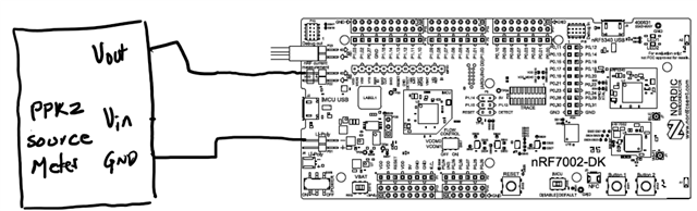

    I have measured the power consumption of the nRF5340 device, applying the following PPK2 connections (quite the same that was indicated in the link you referenced, but measuring the nRF5340 instead of the nRF7002) on the nRF7002DK and the same Wi-Fi Shell example:

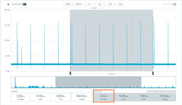

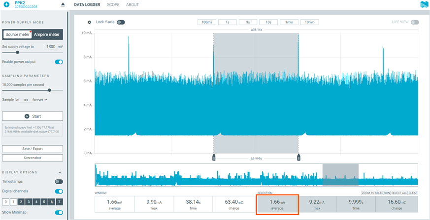

    And I have obtained the same outcome despite the way I connected and configured the PPK2. I am mainly focused between two TWT pings consumption:
    These results on the nRF5340 are quite high. Then, could you please guide me to get the lowest power consumption of the nRF5340 in the scenario I specified above?
    "Connect the Vout on the PPK2 kit to the P23 pin 1 on the nRF7002 DK" from https://docs.nordicsemi.com/bundle/ncs-latest/page/nrf/app_dev/device_guides/nrf70/power_profiling.html
    From your pictures you seem to supply on P22. Is that correct?

    The 2.22mA average you seem is indicating that the nRF5340 for debugging is not going to sleep/power down in between events. What's the nRF5350 doing in between the radio events in your code? Are you using the second nRF5340 for logging or active but still on the DK supply net?

    yes, since my goal is to measure the nRF5340 power consumption, I used the P22 rather than P23. The P23 is used to measure nRF7002 chip power consumption. The solder bridges SB16 and SB17 were modified as you cited, and I got the results you see in my previous response.
    About the behavior among TWT radio events, I just used the Wi-FI Shell example, so I guess that the nRF5340 is not getting a sleep state despite I disabled the serial port logging with CONFIG_SERIAL=n in the same example.

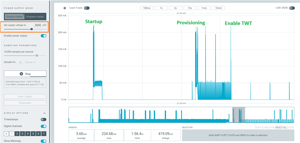

    In the same way, I followed all the steps you cited in the link https://github.com/martelmy/NCS_examples/blob/main/wifi/twt_provisioning_demo/README.md and I got the following results:

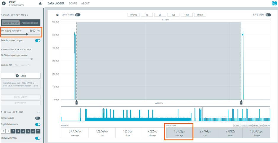

    1. Current measurement on the nRF7002 chip based on the following photo (same as shown in the link)
    And we got those results:

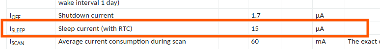

    When making a zoom between TWT intervals (between ping events) we have 18.82 uA (similar to the nRF7002 I_SLEEP value given in the reference manual Table 2):
    2. Current measurement for the nRF5340 device (Host MCU)
    In this case, we followed the documentation steps shown in Using two PPK2s to measure component current consumption in order to measure the consumption on the nRF5340 device, and using the same Firmware example you cited, we got the following result between TWT pings:
    Here is the photo of the connection where we measure only the nRF5340 consumption (please look for the solder jumpers SB16 and SB17 that follow the steps cited):
    As shown, we got the expected results for the nRF7002, but we would need the lowest possible power consumption of the nRF5340 side.
    We've had some more people look into the questions you are seeing and it seems like it's an issue with our side combination of documentation and FW. We are working on updates to be released to described how to achieve the current measurements you want. I will keep you updated on the timeline for the changes we do and to notify you.
