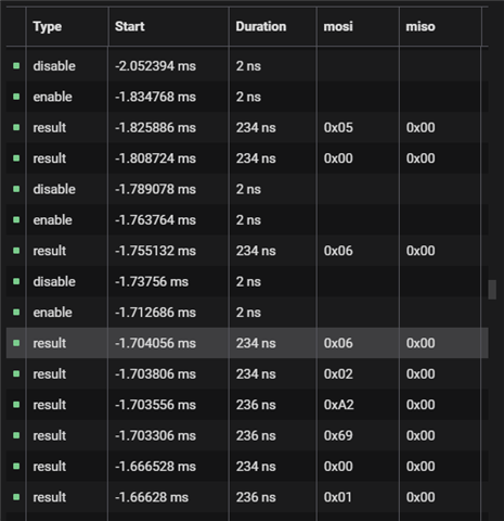

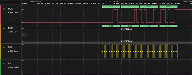

I am chasing down a NOR flash page program failure.  I found the failure occurred after a byte from the previous single-byte SPIM operation was driven at the start of the next SPIM operation.
The expected sequence from spi_nor driver:   WREN (0x06),   Page Program 0xA26900 (0x02, 0xA2, 0x69, 0x00, data)
The sequence observed on SPI bus: WREN (0x06),  Page Program 0xA26900 (0x06, 0x02, 0xA2, 0x69, data)
The page program sequence included an extra 0x06 at the beginning and lost a byte of the address from before the data started.

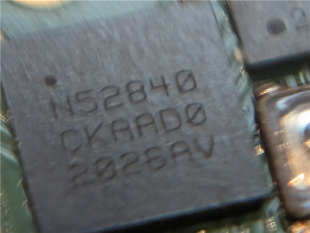

Although this is an nrf52840 and I have seen multiple posts asserting anomaly 109 is not present.. maybe it actually is present?
