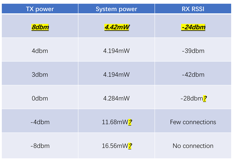

TX power has strange relationship with overall power of chip
I designed a PCB with only the nRF52833 chip and antenna. I want to learn about the relationship between different TX power levels and the overall power consumption of the chip.
I am using a power profiler with a 1.8V supply and reading the average current via software.
During the tests, the TX RX position remains fixed. I obtained the following results:
Why is the received signal strength higher when TX power is 0 dBm compared to when TX power is 4 dBm? Why does the overall power consumption increase when the TX power is reduced to negative values? I look forward to your response.:)

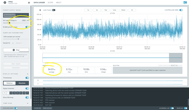

  • Hi
    Please upload an image of how you've powered the board on your end. As the current consumption here looks too low (nano amps) to be set up correctly of a running nRF52833. The maximum current also is just 0.12µA which is not high enough to be the radio running. So if the PPK is indeed supplying the nRF52833 here it shouldn't be able to transmit anything.
    Also, after stopping the Power Profiler app, you should get the option to export the PPK trace as a .ppk file that you can upload here so we can review it.
    Simon
  • I have re-conducted the experiment and uploaded the PPK files (powered at 1.8V) for the following TX settings: 8, 4, 3, 0, -4, and -8. This time, it seems the chip did not work when TX was set to -4, and when TX was set to -8, the chip's power consumption was significantly higher than when TX was set to 8. Additionally, the device could not connect to the central device when the TX value was negative. I have also uploaded my main function code in the files. Thank you very much for your assistance.
