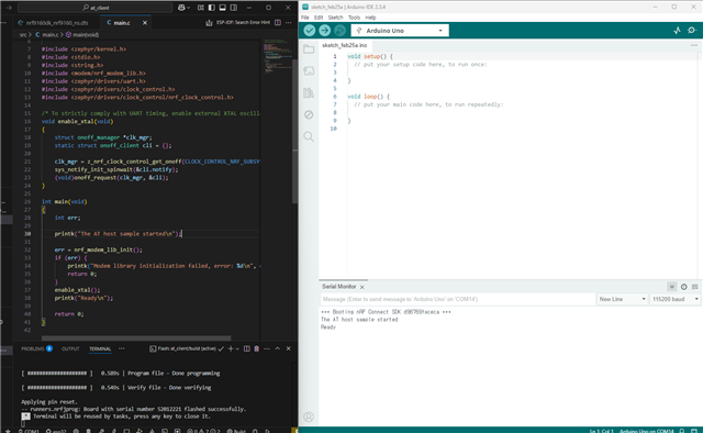

  • Sorry for the late reply.
    First of all, there was a p0.14 p0.13 uart pin, so I opened the uart pin.
    The test was carried out using the serial lte modem code using the AT command. However, unlike the previous development board where the AT command was executed, it was found that the following strange characters were continuously printed in the serial monitor window.
    In addition, I confirmed that the Ready phrase is output when I look at the phrase output through the at_client.
    I don't have a clue what the problem is yet. Is there any other way to check?

    OK
    %XSIM: 1
    OK
    +CPIN: READY
    OK
    204080743141593
    OK
    %CESQ: 55,2,17,2
    OK
    +CEER: "EMM 18"
    OK
    OK
    OK
    OK
    %CESQ: 54,2,12,1
    Nordic Semiconductor ASA
    OK
    %CESQ: 55,2,17,2
    mfw_nrf9160_1.3.7
    OK
    350916069243163
    OK
    %XMODEMUUID: e7a1c54a-b07c-4512-9c3e-8ecbbfe2641d
    OK
    %XDATAPRFL: 2
    OK
    +CEREG: 5,5,"20CF","031ACC09",7,,,"11100000","11100000"
    OK
    %CESQ: 54,2,12,1
    +CFUN: 1
    OK
    OK
    OK
    +CSCON: 1,0
    OK
    +CPAS: 0
    OK
    +CEDRXRDP: 0
    OK
    OK
    %CESQ: 55,2,18,2
    %CONEVAL: 0,0,7,51,16,29,"031ACC09","45006",30,2600,5,0,0,3,1,8,107
    OK
    %XCBAND: (1,2,3,4,5,8,12,13,18,19,20,25,26,28,66)
    OK
    %CESQ: 54,2,12,1
    %XCBAND: 5
    OK
    %CESQ: 54,2,17,2
    %HWVERSION: nRF9160 SICA B1A
    OK
    OK
    %XSYSTEMMODE: 1,1,1,3
    OK
    %XICCID: 8931681011103482494F
    OK
    %XEMPR:
    OK
    +CGDCONT: 0,"IP","globaldata.iot","10.155.56.192",0,0
    OK
    +COPS: 0,2,"45006",7
    OK
    %CESQ: 53,2,12,1
    %XMONITOR: 5,"LG U+","LG U+","45006","20CF",7,5,"031ACC09",30,2600,53,31,"","11100000","11100000","01001001"
    OK
    +CPINR: "SIM PIN",3
    OK
