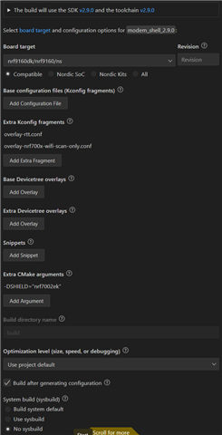

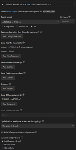

I successfully migrate from the SDK 2.6.1 to 2.9.0.
Now, I am trying to build the modem_shell sample for the nrf9160DK with nrf9160dk_nrf9160_ns.overlay file to support our custom PCB with nrf7000. Previously I successfully did it on the SDK 2.6.1
Sample location \ncs\v2.9.0\nrf\samples\cellular\modem_shell
The only change I did for both sample is to add the nrf9160dk_nrf9160_ns.overlay and CONFIG_WIFI_FIXED_MAC_ADDRESS="f2:01:d5:50:6f:52".
Build both samples with the next options:
As I understand this sample in SDK 2.9.0 doesn't support the sysbuild as there is no "sysbuild.conf" or "Kconfig.sysbuild" files am I correct?
Now I have couple questions:
1. I was able to build the sample with "No sysbuild" check mark in the build configuration but now I am having this error with WIFI which I don't have if I do the same but in the nrfSDK2.6.1

mosh:~$ *** Booting nRF Connect SDK v3.5.99-ncs1-1 ***
Reset reason: PIN reset | software
MOSH version:       v2.6.1
MOSH build id:      custom
MOSH build variant: dev
[00:00:00.409,393] <inf> wifi_nrf_bus: SPIM spi@b000: freq = 8 MHz
mosh:~$ [00:00:00.409,423] <inf> wifi_nrf_bus: SPIM spi@b000: latency = 0
mosh:~$ mosh:~$ Network registration status: searching
Currently active system mode: NB-IoT
LTE cell changed: ID: 151107883, Tracking area: 43150

  • Ok I delete the .overlay file and try to build with the next options:
    The error is the next:
    C:/ncs/v2.9.0/nrf/lib/location/scan_wifi.c
    In file included from C:/ncs/v2.9.0/zephyr/include/zephyr/toolchain/gcc.h:98,
                     from C:/ncs/v2.9.0/zephyr/include/zephyr/toolchain.h:50,
                     from C:/ncs/v2.9.0/zephyr/include/zephyr/kernel_includes.h:23,
                     from C:/ncs/v2.9.0/zephyr/include/zephyr/kernel.h:17,
                     from C:/ncs/v2.9.0/nrf/lib/location/scan_wifi.c:8:
    C:/ncs/v2.9.0/nrf/lib/location/scan_wifi.c: In function 'scan_wifi_init':
    C:/ncs/v2.9.0/zephyr/include/zephyr/device.h:92:41: error: '__device_dts_ord_DT_CHOSEN_ncs_location_wifi_ORD' undeclared (first use in this function)
    In the .config.sysbuild I see that WIFI_NRF70=n, based on that I did assumption that sysbuild doesn't work for this sample.
