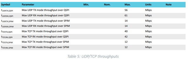

Regarding the above results:
  1. I found that the throughput difference between WiFi 4 (802.11n) and WiFi 6 (802.11ax) is not significant, so I'm afraid that there may have some limitation about nRF7002 in software side.
     2. And the test results do not match the ideal outlined in the Nordic documentation.
Therefore, please provide information about the WiFi measurement environment and the examples used so that I can achieve the throughput specified in the datasheet.

    jiang.ronghui said:
    I conducted several more tests to compare the performance differences between Wi-Fi 6 and Wi-Fi 4 in different testing environments.
    However, I found that the test results for Wi-Fi 4 and Wi-Fi 6 still did not show significant differences.
    Therefore, I would like to ask if the current measurement results in line with the design specifications? If so, what is the significance of using Wi-Fi 6? What are its advantages?
    The advantages with Wi-Fi 6 is not in speed, but in features like Target Wake Time.
    The on-air speed will be more or less equal between Wi-Fi 4 and Wi-Fi 6. This can be seen with the MCS index charts as well:
    https://mcsindex.com/
    Håkon
