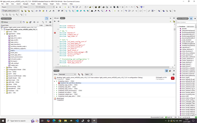

    firstly i open file from this location,
    C:\nrf5sdkformeshv500src\examples\light_switch\server\light_switch_server_nrf52832_xxAA_s132_7_2_0
    in segger embedded studio 5.64 then click on build which show me the error message, which i attach here,
    also i notice that main.c and sdk_config.h file in application folder,
    Please guide me how i solve this error and guide me for segger embedded studio setup also which compatible with nrfsdkformesh.

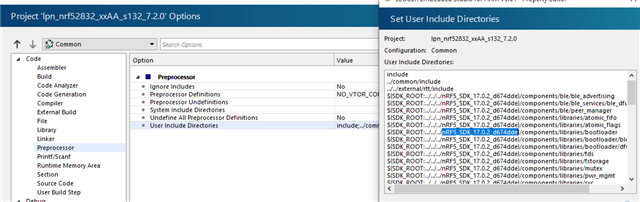

    Also, i try link which you given in upper chart and adding global macro of the nrf sdk as guide in this doc
    https://docs.nordicsemi.com/bundle/nrf5_sdk_mesh/page/md_doc_getting_started_how_to_build.html#how_to_build_segger
    I add global macros like this:
    SDK_ROOT=<C:\nrf5sdkformeshv500src\bin>
    if i am wrong then please suggest me correct method.
    but still facing same issue which mention above.
    Please guide me.

    The reason boards.h is not found is because you need to keep a copy of the "normal" nRF5 SDK: "nRF5_SDK_17.0.2_d674dde" in the same folder as your nRF5 SDK for Mesh. You can see from the include directories that this is where it is looking:
