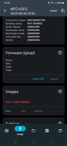

In my project I try to compbine NFC and FOTA (DFU over BLE). First I did setup a NFC project from the example "writable_ndef_msg". This is running. Then I did setup a demo project based on that example: https://academy.nordicsemi.com/courses/nrf-connect-sdk-intermediate/lessons/lesson-8-bootloaders-and-dfu-fota/
But after combining those two example project, FOTA does not run. In the "Device Manager" App on my mobile phone I received a "GATT CONN TIMEOUT" error, after starting a firmware upgrade. To speed up the start time, CONFIG_BOOT_VALIDATE_SLOT0=n is set to no in child_image/mcuboot.conf
I think I missed to set a configuration in the prj.conf file but I have no idea what could be wrong.

  • Hi
    adding this configs does not fix the problem. I stille receive the "GATT CONN TIMEOUT" error, whil trying to upload a firmware with the "Device Manager" App
    CONFIG_FLASH_MAP=y
    CONFIG_STREAM_FLASH=y
    My prj.conf files looks like this:
