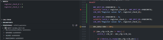

    I've noticed (due to recommendations in other tickets to upgrade our SDK) that the solution we have been using (NRF_NFCT_NS->PADCONFIG=0) no longer works in our project. We previously built using NCS v2.9.1 (where it worked), and have moved to v3.1.1 (no longer working). Tests were completed using non-secure build target, building with TF-M.
    I have also tested on v3.1.1 with TF-M removed (and building with secure target), and NFCT config now works as expected (using NRF_NFCT_S).
    Note, in this specific test, the GPIO was used to drive an LED.
    Mark Laloo
  • Hi Mark,
    Thanks for the additional information on this case, this helps.

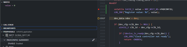

    I configured the NRF5L15 dev kit and resoldered the connections to output to the IO headers. I can observe the same behavior as metioned that the IO does not get unlocked when building with TF-M and the application running non-secured. I can toggle the pin when it is unlocked in a secured build.
    I did some additional testing and noticed that the NRF_NFCT_NS->PADCONFIG is set to 0 inside the driver init as it gets cleared by the POST_KERNEL function I have but the debugger says the register is still set.
    Trying to write to it does alter NRF_NFCT_NS->PADCONFIG but it does not correlate to the actual register as shown by the debugger.

  • Hi Hieu,
    I was able to fix the issue by deleting the PADCONFIG bit manually like suggested by you. I used:
    static int disable_nfc_pads_early(const struct device *unused)
        ARG_UNUSED(unused);
        /* Clear the PADCONFIG bit so the NFC pads stop being forced to NFC */
        NRF_NFCT_NS->PADCONFIG = 0;   /* Use NRF_NFCT_NS if called from non-secure */
        return 0;
    /* Run before GPIO and pinctrl take effect */
    SYS_INIT(disable_nfc_pads_early, PRE_KERNEL_1, 0);
