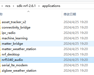

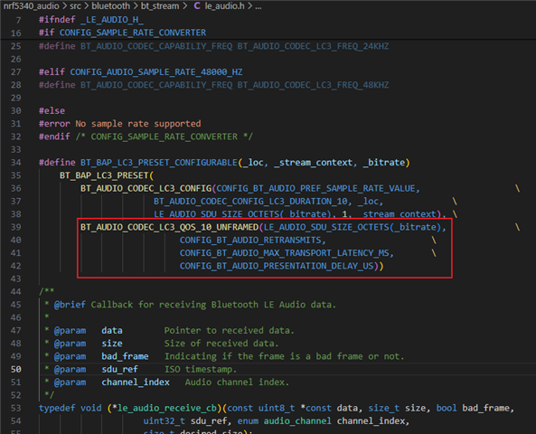

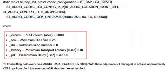

Q2:By the way, I want to change the audio qos configuration in LE Audio application( sdk-nrf/applications/nrf5340_audio ) like this ticket, how to change?
