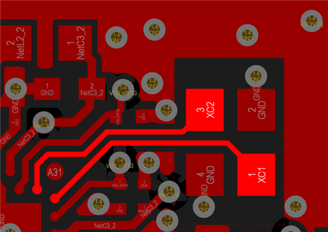

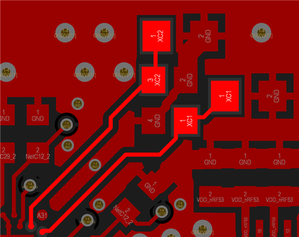

IPC problem with a custom board nrf5340
HI guys, I'm trying to figure out whether the problem I'm having is a hardware or software issue.
So, my problem is: I have created a custom board using the nrf5340 and I'm debugging the hardware/software now. It's a basic PCB with USB and FEM.
In the part of USB, everything worked fine, and I can access the hardware through the USB using the `CDC USB`.
But when I tried to run this sample [openthread/cli](`https://github.com/nrfconnect/sdk-nrf/tree/main/samples/openthread/cli`) and used the command `ot scan` it got stuck and I can't send more to the terminal commands using `ot`.
Then I decided to add the following Kconfigs in my project to see what happened:
CONFIG_OPENTHREAD_LOG_LEVEL_DEBG=y
CONFIG_OPENTHREAD_DEBUG=y
CONFIG_OPENTHREAD_L2_DEBUG=y
and the output in the terminal was:

Ok, is something weird happening here...It gets stuck when I try to transmit the signal, and if we see the datasheet of the (nrf5340 v1.5)[https://docs.nordicsemi.com/bundle/ps_nrf5340/page/chapters/soc_overview/doc/instantiation.html] says:
The application core peripherals are accessible from the network core, but the network core peripherals are not accessible from the application core.
I guess the problem is related to the IPC. Somehow, the application core tries to send the transmission to the network core, and neither the network core nor the application core receives the request or the response.
So, I tried to use the [ipc service sample](https://docs.nordicsemi.com/bundle/ncs-2.6.1/page/nrf/samples/ipc/ipc_service/README.html) to see if the problem is it. The following are the results of `rpmsg_cpuapp_sending` and `icmsg_cpuapp_sending` using just one core:

    You're right, there's an issue with the HFCLK because the loop never ends in the B1. However, I'm even more confused now.
    Can you check the soldering around the HFXTAL? Does it look ok? Is it mounted correctly? (We have seen some times that they are mounted 90 degrees off, so make sure it is in the same orientation as the other working board.)
    I made these two boards manufactured by JLCPCB using the same Gerber file, CPL, and BOM (I only removed the LFCLK from B2). The soldering looks fine to me.
    This is the connection I made in my project. Did I do something wrong?
    My project Thingy53
    I followed the HFCLK placement from Thingy53, although the trace distance in my design is longer, and I used external capacitors.
    Could this affect the probability of my board working properly? In my project, I used an 8pF XTAL so the external capacitors are both 12pF.
    One more thing. I'm not sure if this will help identify the source of the problem. I know the correct approach would be to use an oscilloscope to measure the XTAL clock, but I don't have one here. Instead, I used a multimeter to measure the voltage on the capacitors to see if I could find anything.
    On my B2 (working board), both XC1 and XC2 have 800mV, but on my B1, XC1 has 800mV while XC2 only has 200mV.
    Why is there this voltage difference between the capacitors? What could be causing this difference?
