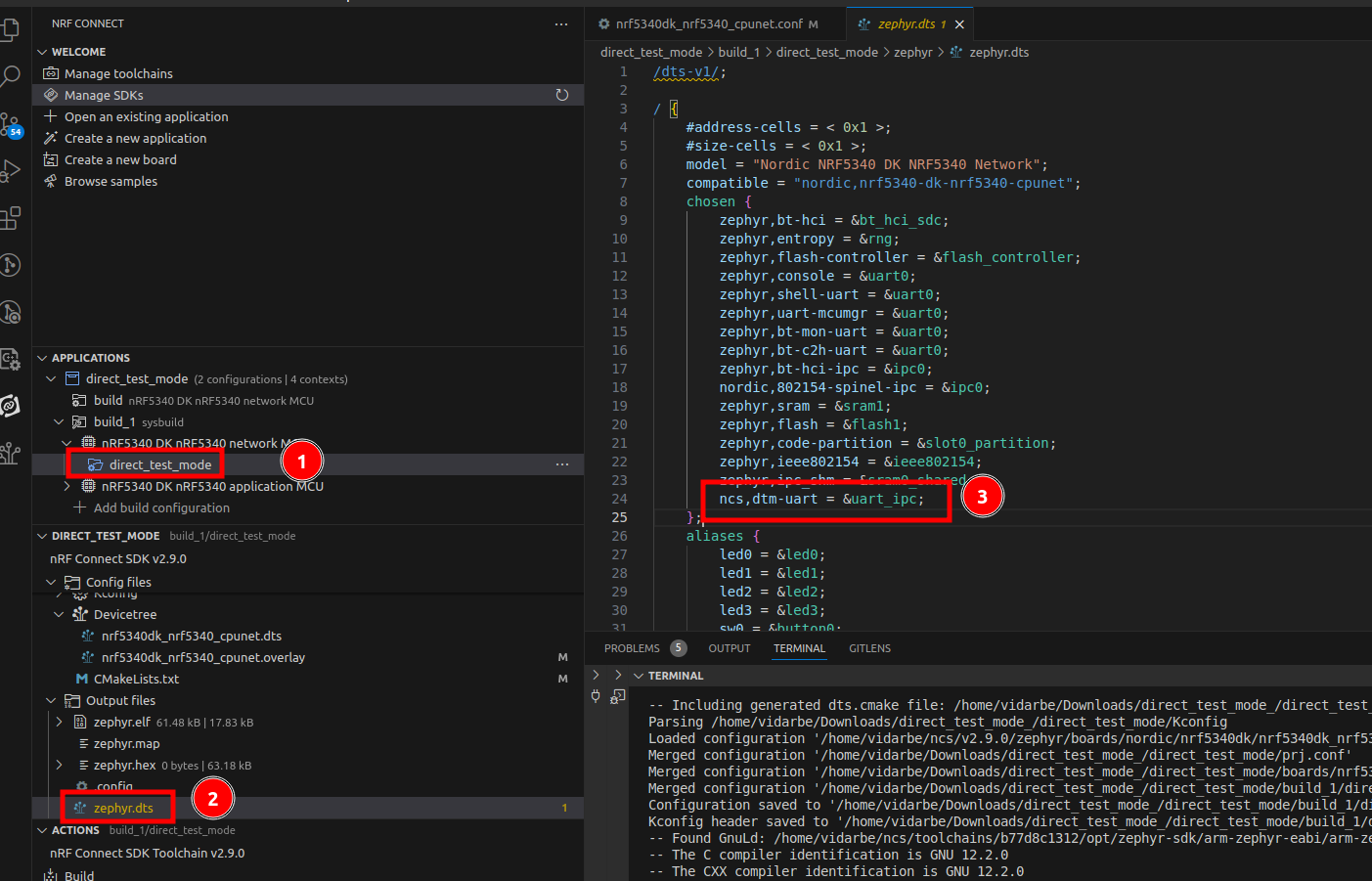

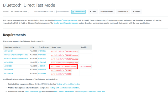

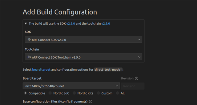

If you get an error saying NRF_RADIO_Type is not defined, it usually means you have attempted to build the project for the application core instead of the network core. The application does not have direct access to the RADIO peripheral.
Supported build target:
https://docs.nordicsemi.com/bundle/ncs-2.9.0/page/nrf/samples/bluetooth/direct_test_mode/README.html
Vidar

I see. Yes, that makes sense. Could you make a zip of the direct_test_mode folder in D:/sw/test54Hello/direct_test_mode and upload it here so I can try to find out why the project fails to build?
Hi Vidar,
the zip I have attached. It is just the nrf sample for DTM.
Please have a look at it
Best regards
Georg5367.direct_test_mode.zip
Hi Georg,
Thanks, I just wanted to make sure nothing was changed in the project configuration. It seemed like the linker errors did not match the source code. Unfortunately, I have not managed to reproduce the build issue here.

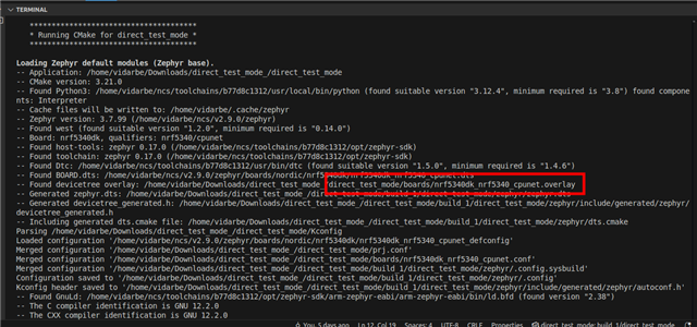

Does your the cmake output in your build log show that this overlay is found as in my case below?
This overlay selects the communication interface to use with DTM:
It would also be helpful if you could share your build log.
Vidar
