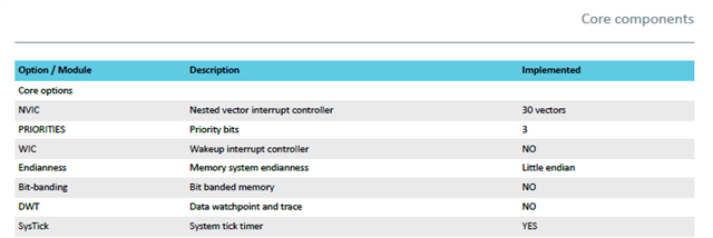

Moving from nrf52832 to nrf52805, nrfx_clock_anomaly_132() hangs on 805.
Existing FW developed on PCA10040 EVB, moved to EVM-BC805 which is the chip for my final board design.  I applied the patch that I found to SDK 17.  However this anomaly function is called based on the existing #defined conditions, even after the patch.
On the 805 it gets stuck in the while loop.   I removed the call to this anomaly function and it seems to run fine, either with xtal or RC.  I am just concerned that this might not be the correct approach I don't want whatever this workaround was originally for, to still occur, even though has worked so far.
