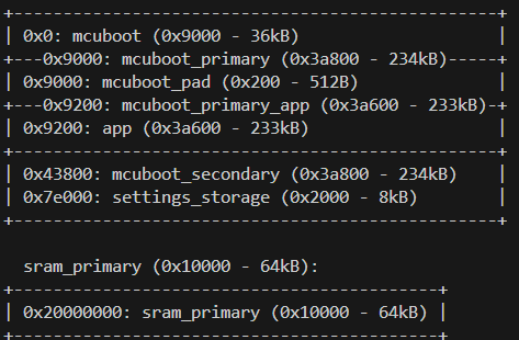

    ←[92m-- west build: running target partition_manager_report
    [1/1] cmd,exe /C "cd /D C:\Users\Ryan\Downloads\peripheral-lbs...eripheral-lbs-sysbuild-main/new_build_sysbuild/partitions.yml"
      flash_primary (0x80000 - 512kB):
    | 0x0: mcuboot (0x9000 - 36kB)                    |
    +---0x9000: mcuboot_primary (0x3a800 - 234kB)-----+
    | 0x9000: mcuboot_pad (0x200 - 512B)              |
    +---0x9200: mcuboot_primary_app (0x3a600 - 233kB)-+
    | 0x9200: app (0x3a600 - 233kB)                   |
    | 0x43800: mcuboot_secondary (0x3a800 - 234kB)    |
    | 0x7e000: settings_storage (0x2000 - 8kB)        |
      sram_primary (0x10000 - 64kB):
    | 0x20000000: sram_primary (0x10000 - 64kB) |
    This seems fine, but when I try to flash I get this error again:
    Building peripheral-lbs-sysbuild-main
    C:\Windows\system32\cmd,exe /d /s /c "west build --build-dir c:/Users/Ryan/Downloads/peripheral-lbs-sysbuild-main/new_build_sysbuild c:/Users/Ryan/Downloads/peripheral-lbs-sysbuild-main"
    ninja: error: '_sysbuild/mcuboot_primary_app_hex', needed by 'mcuboot_primary.hex', missing and no known rule to make it
    FATAL ERROR: command exited with status 1: 'C:\ncs\toolchains\ce3b5ff664\opt\bin\cmake.EXE' --build C:/Users/Ryan/Downloads/peripheral-lbs-sysbuild-main/new_build_sysbuild
      placement:
        align: {start: 0x1000}
      span: [mcuboot_pad, app]
    mcuboot_pad:
      address: 0x10000
      placement:
        before: [mcuboot_primary_app]
    mcuboot_primary_app:
      address: 0x10200
      span: [tfm, app]
      inside: [mcuboot_primary]
      placement:
        after: [mcuboot_pad]
    tfm_secure:
      address: 0x10000
    tfm:
      address: 0x10200
      inside: [tfm_secure]
      placement:
    tfm_nonsecure:
      address: 0x20000
      span: [app]
    app:
      address: 0x20000
    mcuboot_secondary:
      address: 0x80000
      placement:
        after: [mcuboot_primary]
      share_size: [mcuboot_primary]
  • For future visitors to this thread, below is a full example pm_static.yml with the fix suggested by @ .
    mcuboot:
      address: 0x0
      placement:
        before: [mcuboot_primary]
        align: { start: 0x8000, end: 0x8000 }
    mcuboot_primary:
      address: 0x10000
      placement:
    mcuboot_pad:
      address: 0x10000
      placement:
      address: 0x10200
      span: [tfm, app]
      placement:
    tfm_secure:
      address: 0x10000
    tfm:
      address: 0x10200
      placement:
    tfm_nonsecure:
      address: 0x20000
      span: [app]
    app:
      address: 0x20000
    mcuboot_secondary:
      address: 0x80000
      placement:
