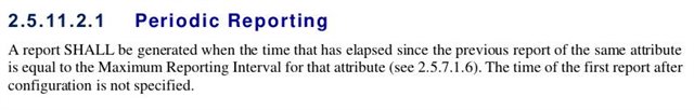

    Which clusters and attributes are you subscribing to, and if the interval set up such that the attributes are supposed to be reported simultaneously, i.e., the max interval is reached simultaneously for all the attributes?
    if values are changed it reflects but if no changes in value and it reaches at max interval set instead of getting all values which are not changed it just gets few values
    Has there been a report (due to changes in values) before this that happened less than 2 minutes ago? Attributes shall be reported after the maximum interval since the last report, so if there was a report due to the value changing in between the periodic reports, then the next report will be 2 minutes after the value change report, and not 2 minutes after the periodic report.
