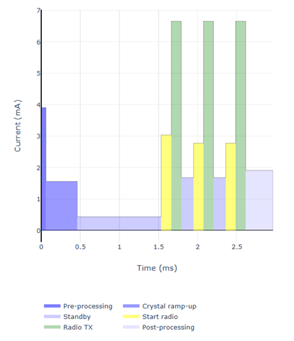

"Online Power Profiler for Bluetooth LE"

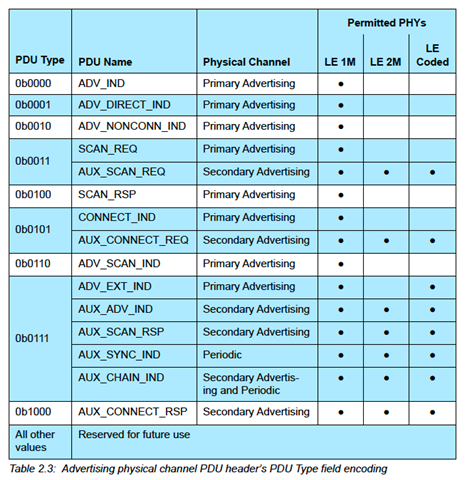

has a BLE role to send non-connectable, non-scannable packet,

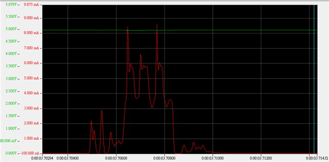

I want to send this kind of advertising packet to test current consumption,

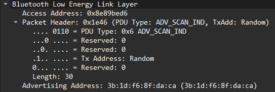

	err = bt_le_adv_start(BT_LE_ADV_NCONN, ad, ARRAY_SIZE(ad), sd,
			      ARRAY_SIZE(sd));
	if (err) {
		LOG_ERR("Advertising failed to start (err %d)", err);
		return 0;
use BT_LE_ADV_NCONN parameter send ADV_SCAN_IND type advertising,
it seems wrong, which parameter of
bt_le_adv_start()
is correct for non-connectable, non-scannable advertising packet?
