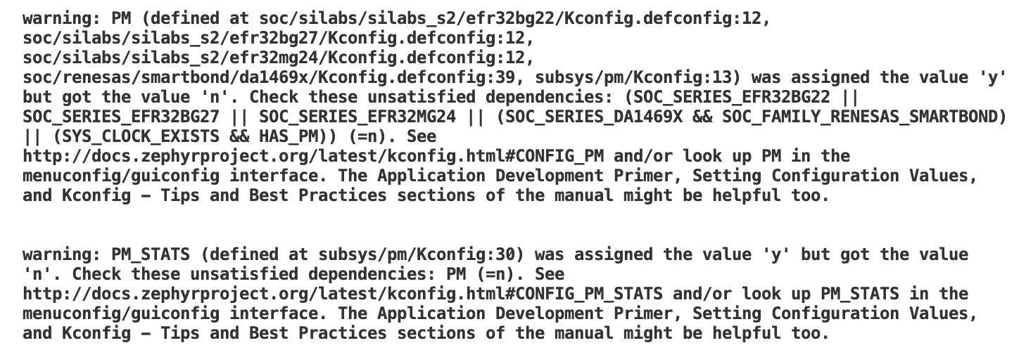

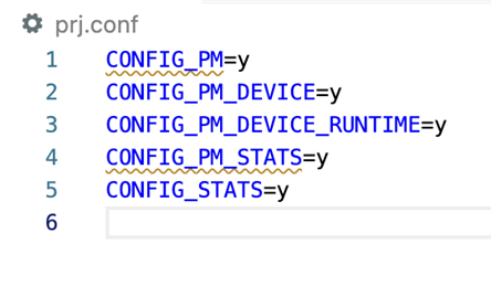

I was working on a project, trying to enable the power management but I could not. So I just tested the simple zephyr sample application device_pm just to see if there is any problem with my code.
But unfortunately when I open the sample application device_pm (https://github.com/zephyrproject-rtos/zephyr/tree/main/samples/subsys/pm/device_pm)
using the nrfConnect SDK v2.9.0 it does not allow the CONFIG_PM to get the value y
As you can see in the following screenshots:
In the build configuration I use the board nrf52840dk/nrf52840 which is compatible with the sample.
I am using a MacBook Air M3, 15.2
Also I build using the nRFConnect SDK 2.9.0 and the Visual Studio Code with the nRFConnect extension.
Is there anything wrong with the latest SDK 2.9.0, or using a MacBook (ARM) to develop?
