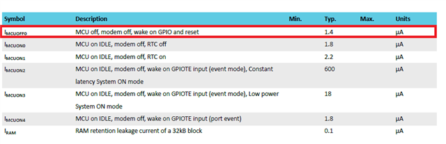

Hi Team,
As mentioned in the datasheet of nRF9151, Imcuoff0 mode (MCU off, modem off, wake on GPIO and reset) consumes around 1.4 uA over VDD power supply then what is the consumption of VDD_GPIO during that case?

VDD_GPIO is included in that measurement.
Håkon
