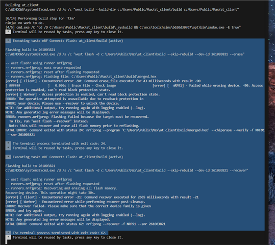

Flashing sample application is failing
  When using the nrf Connect Extension for VS Code, the nRF Connect SDK v2.9.0 and the "at_client Sample" application, flashing the nRF9160 and an actinius icarus board using a J-link results in the following errors. For the build configuration, the "actinius_icarus/nrf9160/ns" target was used. Do you have any ideas how to resolve or debug this? Thank you very much
