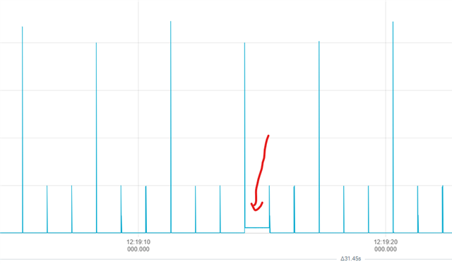

Issue:
What we have noticed is that occasionally (aperiodic) there is a static ~400uA current draw between two ADC conversion triggers (1 second apart). Sometimes this current draw lasts for 2, 3 or even 4 ADC conversion triggers (4 seconds). However it is always initiated at the time ADC measurement is started and it disappears when next ADC measurement is started again.
We werent able to find a configuration/setup to consistently reproduce this issue.
What is most worrisome is that by seemingly random modifications to the code this issue is sometimes less noticeable and sometimes more. It seems that issue emerges when certain timing contraints are violated possibly related to IRQs.
This 400uA current draw is suspiciously similar to errata [241].
We are preety sure that this issue is related to ADC because we have found a fix and it involves modifying ADC behavior.
Fix:
Instead of using interrupt driven ```nrfx_saadc_sample()``` ADC sampling we use a blocking sampling function ```nrf_drv_saadc_sample_convert()```. ADC conversion is then started from RTC2 interrupt and blocked until finished.
