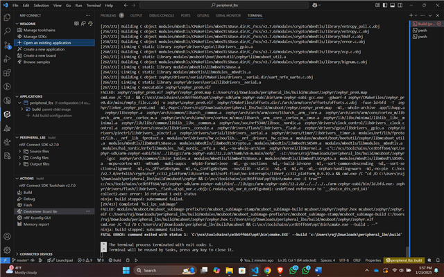

      When I attempt to integrate the TFLite Micro application into the bluetooth_lbs example to combine the functionalities, I encounter multiple issues:
      • Build-Time Issues: Initially, I faced linker errors such as undefined reference to setup and undefined reference to loop functions. I resolved these by ensuring proper function declarations and linking.
      • Runtime Issues: After resolving the build issues, the application crashes at runtime with errors like unaligned memory access and usage faults.
      • Devicetree Conflicts: I noticed errors related to spi_nor (this is also a main headache) and flash memory configurations during the build process, specifically when enabling DFU functionality with the TinyML integration.
    I suspect the issue here is that the 7002dk uses QSPI for communicating with the nRF7002 and QSPi is enabled instead for SPI. So we would need to overwrite the QSPI enabling for the SPI for external flash to work as intended. I'm working on a example application for this. When this is finished I would suggest trying to add the ML model for this sample. If this is not working then we can have a look at it again.

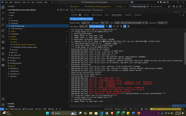

    Thanks again for your continued help and the 6153.peripheral_lbs_ble_fota.zip sample. I’m making progress but have hit a critical roadblock that I need your expertise on.
    I’m trying to combine my working TinyML CIFAR-10 image classification project with your DFU-capable BLE peripheral (6153.peripheral_lbs_ble_fota) on the nRF7002DK board. The idea is to run ML inference on-device and also allow firmware or model updates over Bluetooth using DFU.

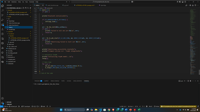

    Individually, both applications work perfectly. TinyML inference runs as expected when deployed alone, and the BLE DFU project allows firmware updates via the nRF Connect mobile app without any issues. However, once I integrate the TFLite-based TinyML application into the DFU BLE sample, the application builds and flashes successfully but crashes at runtime during the model setup phase with a usage fault related to unaligned memory access. The error occurs during the interpreter initialization and tensor arena usage. I’ve already replaced malloc with a statically allocated buffer using alignas(16), tried placing the tensor_arena in the .noinit section, increased stack sizes in prj.conf, and confirmed all includes and CMake paths are correct.
    I moved the entire TinyML logic, including model, interpreter, and inference loop, into src folder and called setup() and loop() after BLE initialization. The BLE DFU functionality remains intact, but the crash still happens when the model is set up. I’ve also tried printing memory layout and reducing arena size, but the fault persists.
    The image I’ve attached here shows the exact error output in the serial monitor. It confirms that the system crashes during the TensorFlow Lite Micro setup with an “unaligned memory access” usage fault, followed by a Zephyr fatal error and system reset.
    Could you please take a look at my TinyML project (TinyML-CIFAR-10_Object_Detection_nrf7002DK) and try to combine it properly with the 6153.peripheral_lbs_ble_fota.zip? The goal is to get both functionalities working together without memory conflicts. I suspect there might be SPI/QSPI conflicts, flash layout or RAM pressure issues, or something related to memory sections and the TF-M runtime. If possible, it would be really helpful if you could provide a working integrated sample or guidance on which regions need to be adjusted to avoid these faults.
    This project is important to me as it is part of my university research, and I’m trying to demonstrate full firmware update capability with on-device TinyML inference. Your support would mean a lot and help me move forward with the paper. Please let me know if you need more logs, source files, or a zipped version of the project. I’ve attached a screenshot of the crash for reference.
