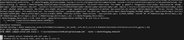

Compile Time Issues with creating a custom driver for SIM7070G, using zephyr and nrf connect SDK v2.6.0
Hi, I am using zephyr and have created a custom DTS for nrf52840 soc. I am using SIM7070G and have created a custom driver for it which is located in (zephyr/drivers/modem/simcom-sim7070g.h). The issue I am facing now is that the main file cannot seem to be getting path for SIM7070G. I have the corrected CONFIGs enabled in prj.conf, have already modified the CMakeLists.txt for modem, alongside modifications in Kconfig and Kconfig for simcom as well, also have added .yaml file in bindings as well. But for some reason it doesn't seem to be working as well either. The file cannot seem to be getting the path for it.
