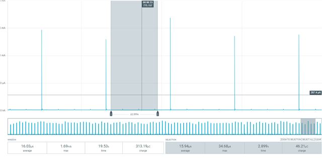

  • HI Simon
        On the basis of the above, the power consumption has returned to normal, around 3uA. At this point, I set the RX pin to interrupt and wait for the interrupt to trigger the wake-up UART. However, the power consumption has reached around 16uA, which seems a bit high. Do you have any suggestions to reduce the power consumption?

  • Hi
    I don't think this is outside expectations. We don't have the measurements done yet for the nRF54L15, but if you refer to the "wake on GPIOTE input sleep mode from I.E. the nRF52840 we can see that the typical current consumption here is 17.37µA. Note that this is just a comparison from previous devices, so the nRF54L15 numbers might be different. But for those we can only wait for the numbers to be added to a future revision of the nRF54L15 datasheet.
    One thing worth noting here, is that if you need the lowest possible GPIOTE current consumption, you should use the GPIOTE30 instance that is drawn from the low power domain and uses pins on P0, as that should be lower on current usage than GPIOTE20 from the peripheral domain.
