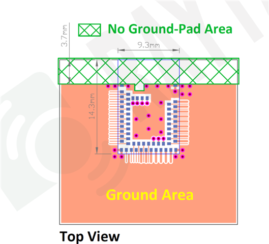

  • Check antenna design constraints. Sound like the signal is not radiated properly, BTLE tends to "work" within 1-2m with an open antenna port...
  • I am using the Raytac MDBT53-1M with integrated antenna. When using an Android or iOs device for reception, I can get results over 50m and fast without problem, so I am thinking there could be something more specific with channels?
  • Hi Michael,
    Which version of the nRF Connect SDK are you using?
    The TX power configuration for the nRF5340 must be done in the config file for the image running on the network core.
    The configs you show sets two TX powers, -20dBm and 8dBm, the nRF5340 have a maximum output power of 3dBm so the 8dBm setting will not work.
    Have the recommended module placement as show in the module datasheet been followed?
    Bendik

    The PCB module placement is respected as you remind me on the picture (ground area respected).
