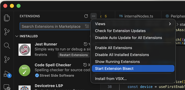

VSCode Extension Host Keeps Crashing As Soon as First Project is Added
Bit baffled by this one, I assume it's related to the attempted nRF SDK Intellisense magic:
We do have a monorepo for various controller projects that includes two zephyr setups in lib/zephyr (latest, for non nRF projects) and lib/nordic (for nRF projects), both gitignored and set up as per respective installation instructions. Command line builds are invoked by either source .venv/bin/activate && west build ... for native Zephyr projects or nrfutil toolchain-manager launch west build -- ... for Nordic ones, with ZEPHYR_BASE etc set beforehand, and build well with all the right respective variables and dirs set.
The issue is that on an M2 MacBook, as soon as we add a project dir to the NRF CONNECT extension, the Extension Host keeps crashing every 30 seconds or so.
No error is given in any of the consoles / outputs, including the vscode js developer console. Intuitively it feels like some logic looking for manifest files, includes, ways to set up Intellisense etc gets lost or runs out of memory / in circles.
Observations:
- Most functionality of the extension does work (until it crashes), including adding build configurations, building, flashing, connecting do devices and outputs etc.
- At startup, the Extension reports multiple, mostly lib/zephyr/zephyr and lib/nordic/zephyr, but sometimes random (Found manifest file: /Users/bruno/meso/firmware/lib/nordic/modules/hal/nxp/mcux/mcux-sdk/west.yml) manifest files and suggests to initialize them, despite the main West workspaces already being initialized.
- Occasional nRF error being shown: "HMv2 SOCs must be passed to determine identifier components."
What we tried so far:
- Creating a completely blank c_cpp_properties.json configuration, cleaning up settings.json, and disabling all other Extensions with Extension bisect and manually.
- Trying to find any traces of the actual error.
- Trying to figure out if the NRF Extension traverses the entire monorepo (way too much) when trying to automate the Intellisense setup, or if it can be limited to our lib/nordic folder within it.

    You can also use the following to narrow it down to the extension that creates this issue:
    -Priyanka
  • Completely fresh install on new machine with latest version as per docs. Bisect doesn't work, but deactivating nrfSDK in VSCode is what prevents the error.

  • I hit this similarly on an M1 MacBook Air just today. I've been doing most of my development on an M4 MacMini and never saw this, but had moved development over to the MacBook due to potential power loss due to winter storms.
    I see evidence of high memory pressure on the M1 Air, probably because it only has 8GB RAM vs. the M4 Mini's 16GB, but the problem started happening when I was working with devicetree, and if I disable the nRF Devicetree extension (version 2026.1.448), the problem disappears, but so do the devicetree related features, such as listing the specific build target systems in the nRF Connect Applications sidebar, for example. Note that since I hit the issue, I've been working editing application source, not device tree, but the error persists.
    I found that this was the cause by digging into the error logs generated by the Extensions Host--it was holding onto the CPU and unresponsive for 81% of almost 5 seconds at a time, which caused the Host to crash, so it's possible that memory and/or system speed plus aggressive crash timing by the Extensions Host is involved, which would explain why the exact same cloned environment does not experience any issues on the M4 Mini.
    Update: Removing the nRF Devicetree Extension then fully closing VS Code, then reopening VS Code and Installing the extension again seems to have cleared up the issue.
