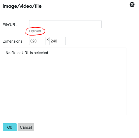

    Don't know how ti attach zip

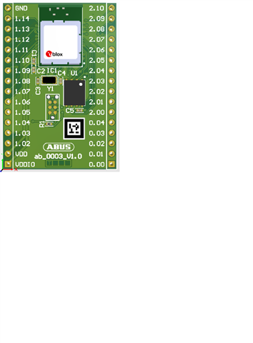

    I used a Ublox NORA-B206-00B on a prototype PCB
    just drag and drop it into where you are typing. Alternatively: Insert -> image/video/file -> then click the upload button:
    It is not clear to me whether they have put a 32kHz Crystal (LFXTAL) in that module. I can't seem to find any datasheets. If you are not sure, reach out to the distributer that you used to purchase the module, and ask if you can get the datasheet.
