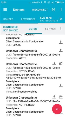

How to use the nordic android ble library, I have implemented it but only once when on the road can receive data. From the BLE device every minute sends data.
I tried to read data through the nrf connect application the results are as follows:
Do the read characteristic and disable notification symbols have an effect like in https://github.com/NordicSemiconductor/Android-nRF-Connect/tree/main/documentation
my code snippet is as follows:
