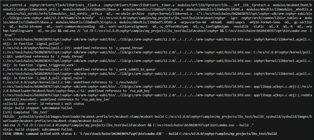

I am trying to repeat the functionality of the project that is shown in this video https://www.youtube.com/watch?v=fCU8x-pmtqU&list=PLx_tBuQ_KSqG-leiJDfOKf_ZmCqHnbi4r&index=8&ab_channel=NordicSemiconductor.
I get the following errors:
Here is my sysbuild.conf:

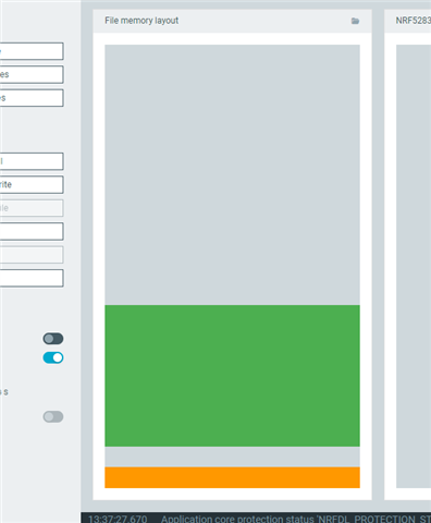

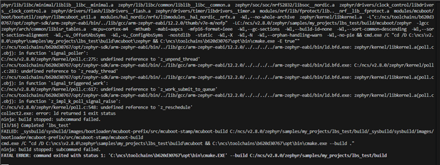

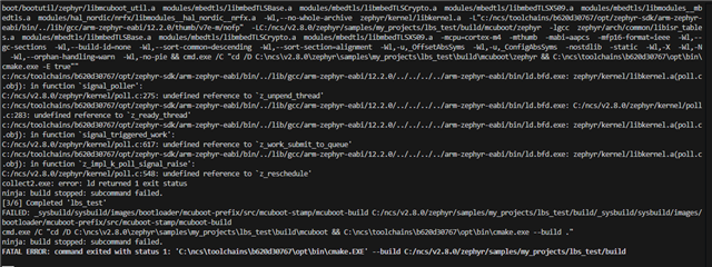

  • Hello. Yes, for, DK everything is built. CONFIG_MULTITHREADING=y did not help. I made some changes to my board file (added toolchain:
    - zephyr
    - gnuarmemb
    - xtools
    supported:
    - gpio
    - nvs
    - i2c
    - spi) and everything is built, but I can't flash the board. I also get a warning in mcuboot.conf: The active build context 'build' does not use this file.
    Can you please tell me what hex files I need to find to flash the board manually using the NRF programmer? I try to flash c:\ncs\v2.8.0\zephyr\samples\my_projects\lbs_test\build\mcuboot\zephyr\zephyr.hex and c:\ncs\v2.8.0\zephyr\samples\my_projects\lbs_test\build\lbs_test\zephyr\zephyr.signed but nothing happens. It looks like this.
