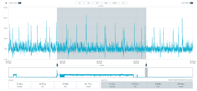

I am having problems getting PSM mode, or at least getting a decent power consumption in PSM mode, because I think the PSM in working properly.
I am using the EVB nRF9151-DK but I am not able to get a current consumption about 4-5uA.
This is my prj.conf:

I am using the GNSS, but after the fix it should go to sleep. Besides, it seems to be the operator is giving to me the right timers T3314 and T324 and going in PSM mode properly:

[00:01:02.043,273] <inf> lte_gnss_udp: Modem Enter PSM, time 86351546
This is my power profile, and it seems to be that the PSM is to reach correctly, but the power consumption is not right. I am using the Power Profile Kit II, and I have connected the USB debugger:
As you can see the average is around 588 uA when it should be about 4-5 uA.
Does anyone any suggestion??
