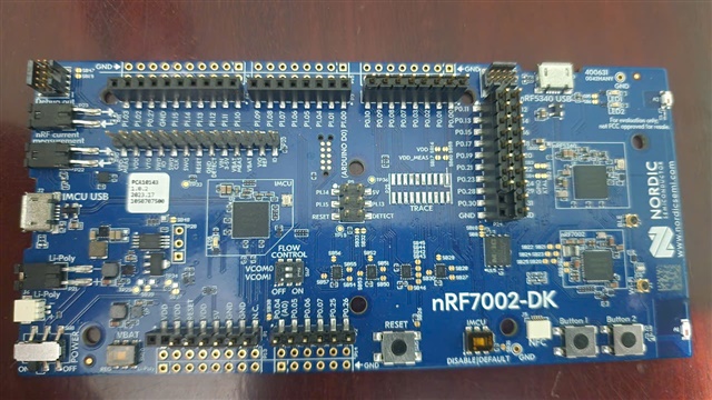

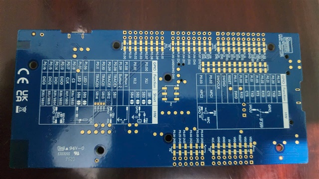

    2. Note that some of the pins are connected to other function on the DK already
    I'm using nRF7002-DK (PCA10143). I checked this don't use the pin 0.06, 0.07, 0.26 and 0.25.
    Below is the detailed image of the board I used.
