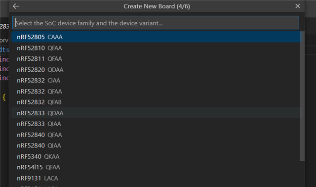

I'm using ezurio BL653µ and want to create a custom board in ncs2.8.0 (HWMv2) but i cannot sellect the nRF52833-CJAA variant.
What do i do? Do i select another variant and take care to only use the pins of the CJAA variant?
Yes, you can find from the ordering code that they have the same amount of flash and ram, so it's only the package that is different:
https://docs.nordicsemi.com/bundle/ps_nrf52833/page/ordering_info.html
