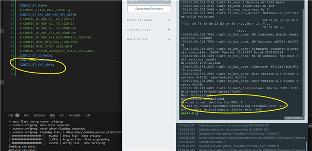

    This is most likely not the reason for your fault, but could you enable CONFIG_BT_EXT_ADV=y? https://docs.nordicsemi.com/bundle/ncs-2.8.0/page/kconfig/index.html#CONFIG_BT_EXT_ADV_MAX_ADV_SET depends on that configuration and AFAIK from your prj.conf I can't see that you've enabled extended advertising
    Andreas
  • Thank you so much for your reply! I just tried the config but still cannot start ADV
  • Noted,

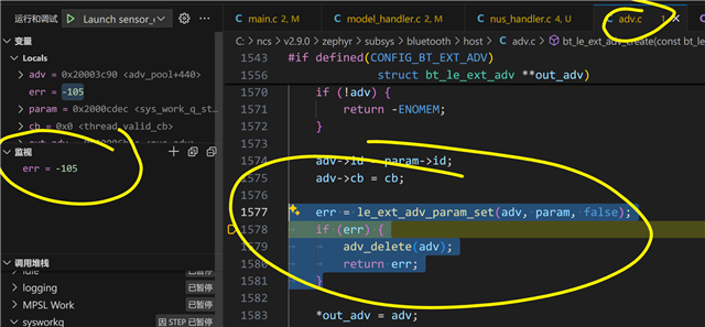

  • Dear Andreas,
    Thank you for your suggestion! I have tried to do the debug and I think the problem is ENOBUFS.
    static int le_ext_adv_param_set(struct bt_le_ext_adv *adv,
    				const struct bt_le_adv_param *param,
    				bool  has_scan_data)
    	struct bt_hci_cp_le_set_ext_adv_param *cp;
    	bool dir_adv = param->peer != NULL, scannable;
    	struct net_buf *buf, *rsp;
    	int err;
    	enum adv_name_type name_type;
    	uint16_t props = 0;
    	buf = bt_hci_cmd_create(BT_HCI_OP_LE_SET_EXT_ADV_PARAM, sizeof(*cp));
    	if (!buf) {
    		return -ENOBUFS;
    	cp = net_buf_add(buf, sizeof(*cp));
    	(void)memset(cp, 0, sizeof(*cp));
    	adv->options = param->options;
    	err = bt_id_set_adv_own_addr(adv, param->options, dir_adv,
    				     &cp->own_addr_type);
    	if (err) {
    		net_buf_unref(buf);
    		return err;
    	if (dir_adv) {
    		bt_addr_le_copy(&adv->target_addr, param->peer);
    	} else {
    		bt_addr_le_copy(&adv->target_addr, BT_ADDR_LE_ANY);
    	name_type = get_adv_name_type_param(param);
    	cp->handle = adv->handle;
    	sys_put_le24(param->interval_min, cp->prim_min_interval);
    	sys_put_le24(param->interval_max, cp->prim_max_interval);
    	cp->prim_channel_map = get_adv_channel_map(param->options);
    	cp->filter_policy = get_filter_policy(param->options);
    	cp->tx_power = BT_HCI_LE_ADV_TX_POWER_NO_PREF;
    	cp->prim_adv_phy = BT_HCI_LE_PHY_1M;
    	if ((param->options & BT_LE_ADV_OPT_EXT_ADV) &&
    	    !(param->options & BT_LE_ADV_OPT_NO_2M)) {
    		cp->sec_adv_phy = BT_HCI_LE_PHY_2M;
    	} else {
    		cp->sec_adv_phy = BT_HCI_LE_PHY_1M;
    	if (param->options & BT_LE_ADV_OPT_CODED) {
    		cp->prim_adv_phy = BT_HCI_LE_PHY_CODED;
    		cp->sec_adv_phy = BT_HCI_LE_PHY_CODED;
    	if (!(param->options & BT_LE_ADV_OPT_EXT_ADV)) {
    		props |= BT_HCI_LE_ADV_PROP_LEGACY;
    	if (param->options & BT_LE_ADV_OPT_USE_TX_POWER) {
    		props |= BT_HCI_LE_ADV_PROP_TX_POWER;
    	if (param->options & BT_LE_ADV_OPT_ANONYMOUS) {
    		props |= BT_HCI_LE_ADV_PROP_ANON;

  • Dear Ahaug
    Today I have successfully monitor the varible "err" and I found whenever the code go through this function, it will return err = -105
    err = le_ext_adv_param_set(adv, param, false);
        if (err) {
            adv_delete(adv);
            return err;
    However, I cannor go deeper than this function. Sometimes when I go into this function it will return err -105, sometimes cannot. So I currenrly can only say that this function leads the problems.
    Could you please help me to figure it out?Smiley

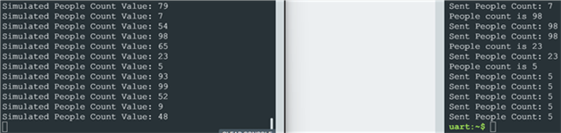

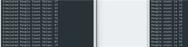

  • Dear Andreas,
    Today I have tried to change ble_peripheral_lbs_coex 's LBS service to my nus_handler, and I can get the data through NUS central. Though there are still some problems that BLE mesh sometimes is not compatible to NUS, it turn out that the my NUS code is OK. So the problems should be beteween BLE mesh sensor client and BLE mesh onoff. What is the difference between these two, I hope you could help me figure out Grin
    I have successfully intergrate these two together, however, I notice a issue.
    1.When NUS is not connected, the sensor client can get the readings correctly every time it requests.
    2.When the nus is connected, the sensor client can make the correct request, but sometimes it cannot receive the correct data, causing the last received data to be used
    Below are my code:

    CONFIG_BT_EXT_ADV=y
    CONFIG_BT_EXT_ADV_MAX_ADV_SET=9
    # CONFIG_BT_BUF_ACL_RX_SIZE=27
    # CONFIG_BT_BUF_ACL_TX_SIZE=27
    # CONFIG_BT_BUF_ACL_TX_COUNT=10
    # CONFIG_BT_BUF_EVT_RX_COUNT=10
    # CONFIG_BT_BUF_EVT_DISCARDABLE_SIZE=58
    # CONFIG_HEAP_MEM_POOL_SIZE=4096
    # CONFIG_MAIN_STACK_SIZE=2048
    # CONFIG_SYSTEM_WORKQUEUE_STACK_SIZE=4096
    CONFIG_BT_ID_MAX=9
    CONFIG_BT_MAX_CONN=9
    CONFIG_BT_BUF_CMD_TX_COUNT=30
    #为了调试加的
    CONFIG_LOG=y
    #CONFIG_LOG_DEFAULT_LEVEL=4
    Thank you so much for your time!
    Below are my code:
