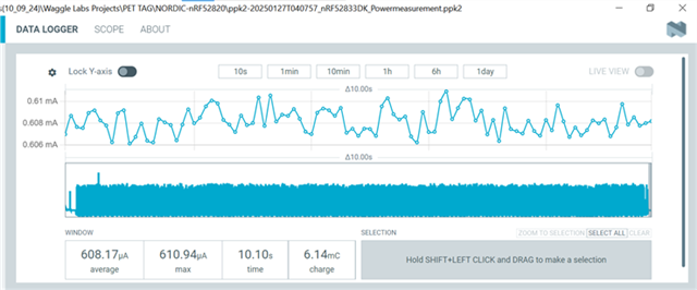

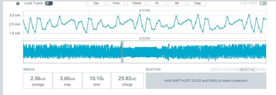

We have checked the current consumption  in nRF52833 DK using  the Power profiler Kit II  and tested with  two different builds .I have provided the file path below for your reference
1.https://github.com/nrfconnect/sdk-zephyr/blob/1aa2f9d42791ff37061af43aa8fa97120f9fbeb7/samples/bluetooth/peripheral_gatt_write/src/peripheral_gatt_write.c
2.https://docs.nordicsemi.com/bundle/ncs-latest/page/nrf/samples/bluetooth/central_and_peripheral_hr/README.html
In the Peripheral_Gatt_write build the observed current values are as below:
a.Average Current consumed when BLE advertising : 608.17 uA
b.Average Current consumed when BLE connected with mobile using nRFConnect App : 700 uA.
In the Central_and_Peripheral_hr build  the observed current values are as below:
a.Average Current consumed when BLE advertising : 2.56 mA
b.Average Current consumed when BLE connected with mobile using nRFConnect App : 2.56 mA

    1.Central_and_Peripheral_hr:
    2. Peripheral_Gatt_write

    1. Yes, I think you should be lower the power consumption of the central_and_peripheral_hr. During advertising and connections lowering it below 100µA might be to expect too much, depending on the parameters you require of course. You can use the Online Power Profiler for some estimates on what to expect in various Bluetooth operations. Since you see current consumption on multiple mA's I'm guessing debugging/logging and serial is enabled, as those tend to draw a lot of power. That being said. These current consumption plots seem very strange, and it doesn't seem like an application operating as expected. Can you show me how the PPK2 is connected to the device you're measuring on exactly?
