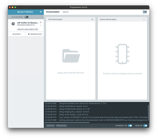

I've write successfully the  "sniffer_nrf52840dongle_nrf52840_4.1.1.hex" program into the nrf52840 usb stick with help of "nRF Connect for Desktop"

After that light start blinking Yellow color on USB dongle.
When i refresh a interface in Wireshark not listing it.
