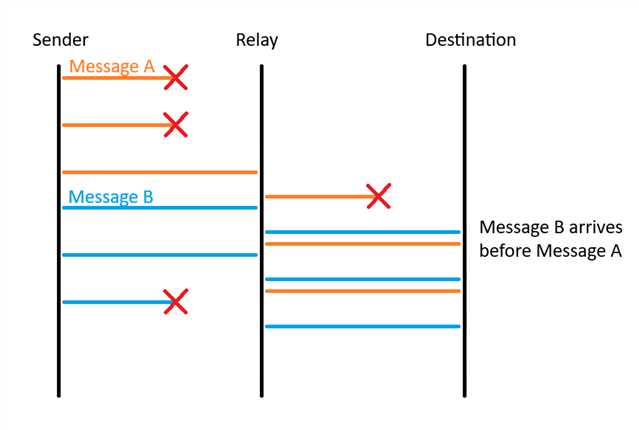

Hello.
I am developing using nRF5340DK and nRF Connect SDK v2.9.0.
However, this PR has been applied.
I connected one smartphone app and two boards(nRF5340DK) to the mesh network.
When I sent multiple messages requiring a response from the smartphone app to the board, replay protection was detected.
  1. Send five messages from the smartphone app.
  2. A board that is not the destination relays messages.
    relay.log line: 1-20
    dst 0x148d seq 0x2d27
    dst 0x148b seq 0x2d28
    dst 0x1492 seq 0x2d29
    dst 0x1490 seq 0x2d2a
    dst 0x1491 seq 0x2d2b
    The order of reception and sequence numbers is correct
  3. A board that is the destination processes messages.
    target.log line: 1-81
    Message "dst 0x148d seq 0x2d27" was not processed due to replay protection because Message "dst 0x148b seq 0x2d28" was processed first. line: 12-13

    When the packets of a Bluetooth Mesh message are transmitted and relayed, they are not sent only once. Rather, they are repeated, according to a configuration for the number of repeats.
    From the node sending the message, the packets will be sent 1 + Network Transmit Count number of times.
    From the relay node, the packets will be sent 1 + Relay Retransmit Count number of times. Further, the intervals between those retransmissions are controlled by Network Transmit Interval and Relay Retransmit Interval, for originating node and relay nodes respectively.
    If you send a message B shortly after a message A, you may end up with the first transmission of the packet containing message B being sent before the last retransmissions of the packet containing message B. Typically this can happen at the relay, especially if the first original transmission for packet A was lost, so that the relay starts relaying after receiving the second or third transmission for that packet.
    The following figure shows one example of message order inversion. In this case there is a lot of packet loss. Depending on parameters and timing, as little as one dropped packet might in some situations be enough to cause out-of-order message reception.
    To reliably send multiple messages in a row, you can use segmented messages. With segmented messages, the sender is only allowed to send one message at the time. The transmission is considered completed when the message has been ACKed, and then the next message can be sent. Therefore, there is no message order inversion when using segmented messages, regardless of number of relays and amount of packet loss along the way. ACKing of segmented messages is handled by the Bluetooth Mesh stack at the lower transport layer.
    See Segmentation and reassembly (SAR) for details on segmented messages.
    Please note that the maximum payload for the first segment of a segmented message (8 bytes including opcode) is three bytes less than the maximum payload for an unsegmented message (11 bytes including opcode). This means some messages that originally fits in one unsegmented packet will require two packets when segmented, and therefore take slightly longer to transmit. On the other hand, in the case of a unicast destination, retransmissions are cancelled when ACKed, which means less time is typically spent at the sender end for sending the message.

  • Hi Terje,
    Thank you for your thorough explanation. If reliable sending is necessary, I will try segmented messages.
