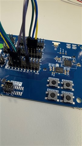

To perform this test on the nRF54L15 DK I had to realize a couple of board settings / solder bridge configurations :
  • I disabled UART0 through the Nordic Board Configuration tool to disconnect P0.0 to P0.3 from on-board debugger.
  • I cut solder bridges SB11 to SB16 to disconnect P2.0 to P2.3 from QSPI flash memory and shortcut solder bridges SB17 to SB22 to connect P2.0 to P2.3 to the P2 GPIO connector.

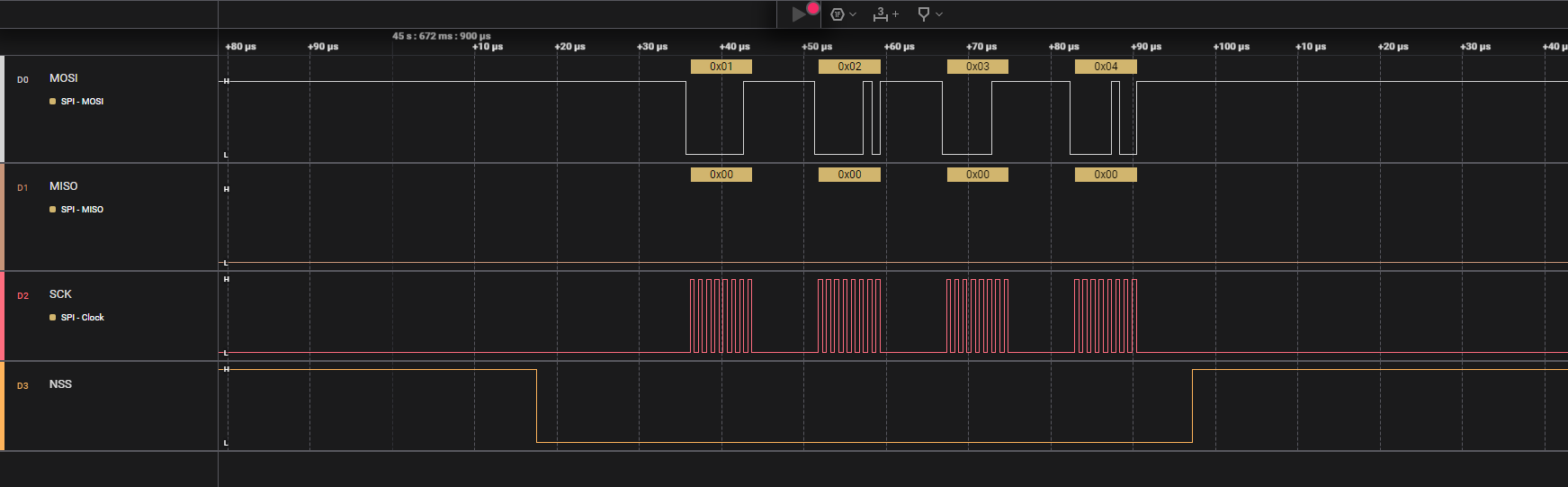

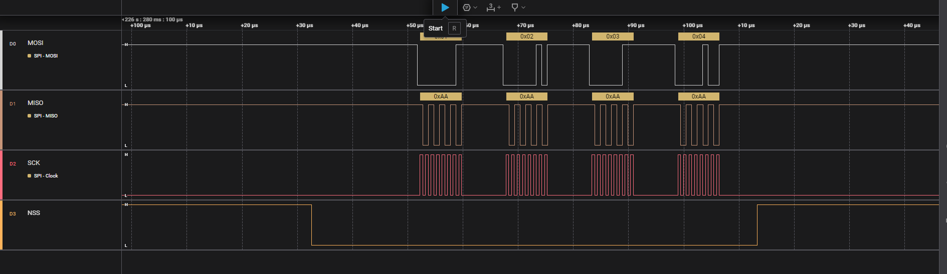

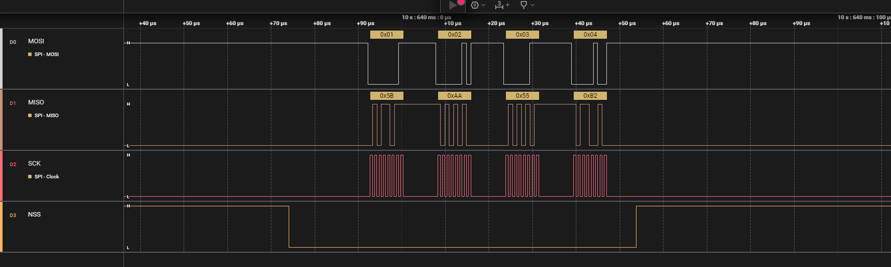

You can see on the SPI communication traces bellow that the nRF54L15 correctly returns the Tx buffer content when using SPIS30, but MISO line stay flat when using SPIS00 intance.

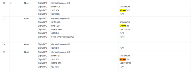

    Looking at the pin assignments information I can find there are very specific pins on Port2 that can be used by SPIS00/20, ref:
    https://docs.nordicsemi.com/bundle/ps_nrf54L15/page/chapters/pin.html
    Can you make sure to use those?
    It doesn't seem as there any specific requirement for which pin that can be used as CSN though.

    Thank you so much for these hints. We are progressing... Indeed, when I select the specific pins specified in the "Pin assignments" chapter of the datasheet I can see an activity on the SPI slave interface.
    By the way, there are some mismatches in the datasheet Nordic should fix : The SPIS Peripheral - Configuration chapter specifies that SPIS00 instance can be mapped on GPIO port P2 without indicating that specific pins have to be used (at the opposite of SPIS20/21/22 instances).

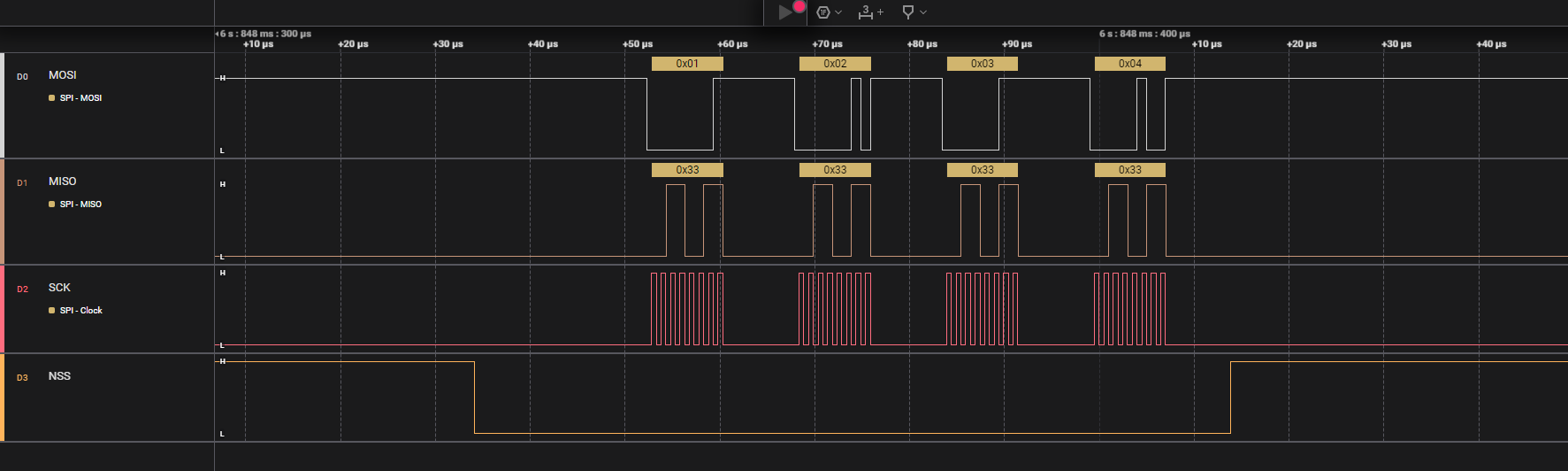

    Unfortunately, I am now facing another issue : as you can see on the new SPI communication trace, the SPIS peripheral only transmits ORC bytes, not the Tx buffer content. Furthermore, the NRFX_SPIS_XFER_DONE event is never triggered by the library. It looks like nrfx_spis_buffers_set command doesn't configure correctly the SPI transaction even if the returned status

    Anyway, I changed the ORC value to 0xAA in my example and I added the following lines before initializing the SPIS driver :
        // Initialize the POWER module
        nrfx_power_config_t power_config = {0};
        status = nrfx_power_init(&power_config);
        NRFX_ASSERT(status == NRFX_SUCCESS);
        // Request constant latency mode
        status = nrfx_power_constlat_mode_request();
    I also enabled the nrfx POWER driver in the prj.conf
    CONFIG_NRFX_POWER=y
    But I am facing the same troubles with ORC bytes transmitted on SDO line :
    Could it be a problem related to the DMA init or transfer on SPIS00 instance ?

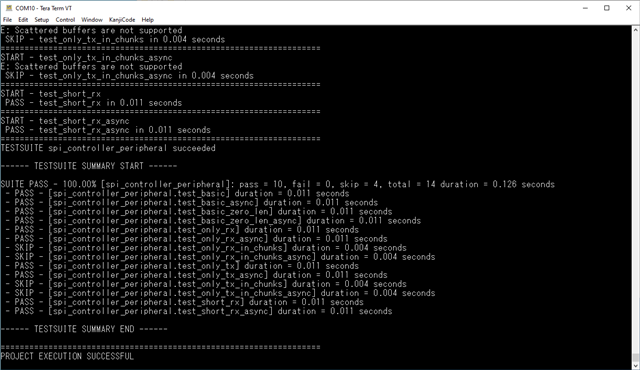

    I updated the \v2.9.0\zephyr\tests\drivers\spi\spi_controller_peripheral\ example to use spi00 with the specified gpios, and it seems to work here. Attaching relevant files. Hope it can be of use.
    Kenneth
