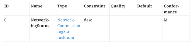

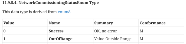

[1738239977.943] [9682:9684] [DMG] Received Command Response Data, Endpoint=0 Cluster=0x0000_0031 Command=0x0000_0005
[1738239977.943] [9682:9684] [CTL] Received NetworkConfig response, networkingStatus=1
[1738239977.943] [9682:9684] [CTL] Error on commissioning step 'ThreadNetworkSetup': 'src/controller/CHIPDeviceController.cpp:2775: CHIP Error 0x000000AC: Internal error'
[1738239977.943] [9682:9684] [CTL] Going from commissioning step 'ThreadNetworkSetup' with lastErr = 'src/controller/CHIPDeviceController.cpp:2775: CHIP Error 0x000000AC: Internal error' -> 'Cleanup'
[1738239977.943] [9682:9684] [CTL] Performing next commissioning step 'Cleanup' with completion status = 'src/controller/CHIPDeviceController.cpp:2775: CHIP Error 0x000000AC: Internal error'
[1738239977.943] [9682:9684] [CTL] Successfully finished commissioning step 'Cleanup'
[1738239977.943] [9682:9684] [CTL] Commissioning complete for node ID 0x0000000000002221: src/controller/CHIPDeviceController.cpp:2775: CHIP Error 0x000000AC: Internal error
[1738239977.943] [9682:9684] [TOO] Device commissioning Failure: src/controller/CHIPDeviceController.cpp:2775: CHIP Error 0x000000AC: Internal error
[1738239977.943] [9682:9684] [TOO] Run command failure: src/controller/CHIPDeviceController.cpp:2775: CHIP Error 0x000000AC: Internal error

  • Hi Bhavya,
    I used the Matter core specification and looked up the NetworkConfig response command. This shows that the NetworkingStatus field is of the data type NetworkCommissioningStatusEnum.
    Looking up this data type, I found the different values, such as value 1 being OutOfRange.
    The NetworkConfig response command can be found in chapter 11.9.7.7 in v1.4 of the Matter spec, and the NetworkCommissioningStatusEnum type can be found in chapter 11.9.5.4.
    If you are a member of CSA, you can receive the Matter specification through a specification download request at CSA's website here: https://csa-iot.org/developer-resource/specifications-download-request/.
    Marte
