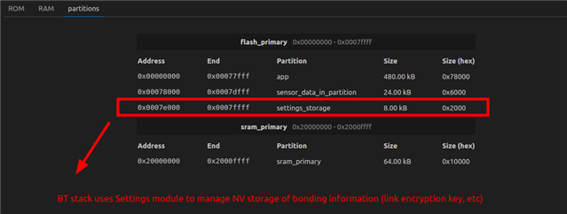

The problems with starting advertising started after I wanted to add NVS (most likely). The error occurs in the bt_le_adv_start function
What does this error mean and how can I fix it?
Here is my overlay for new memory partition (sensor_data_in_partition here for NVS):

Here is prj.conf
CONFIG_LOG=y
# Button and LED library
CONFIG_DK_LIBRARY=y
# Bluetooth LE
CONFIG_BT=y
CONFIG_BT_PERIPHERAL=y
CONFIG_BT_DEVICE_NAME="MY_LBS1"
CONFIG_BT_SMP=y
# Increase stack size for the main thread and System Workqueue
CONFIG_MAIN_STACK_SIZE=2048
CONFIG_NVS=y
CONFIG_BT_NSMS=y
CONFIG_SPI=y
CONFIG_GPIO=y
CONFIG_PRINTK=y
CONFIG_USE_SEGGER_RTT=y
I use ncs 2.8.0 with the custom board with an nrf52832 chip.
I would be grateful for help.
