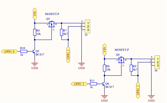

Hello, I am working on a project that is in charge of measuring temperature and sending values ​​via BLE. I am working with the DS18B20 sensor and I have helped myself a lot with the examples that Zephyr offers.
I have 2 devices connected to one One-wire bus, and in order to receive values ​​from each sensor, I have to manually enter their ROM addresses.
This manual entry is inefficient and I would like to make a "ROM finder" that would at least print the ROM addresses of devices connected to the bus.
J3 and J4 represent the header on which the one-wire is connected and with the help of GPIO 1 and GPIO 3 I am able to read data from the sensor (only if GPIO_0 and GPIO_2 are in the state of logic 1)

I am currently receiving invalid addresses that I cannot use.
I will be very happy for any advice. I REALLY can't move on from this….
