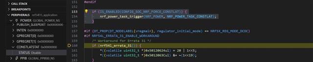

Do you use BLE or MPSL? In that case I guess you need to use this function https://github.com/NordicSemiconductor/nrfx/blob/32f47b3f6cadb175266e3a9c5faf4a730ad76ac0/drivers/include/nrfx_power.h#L361 because MPSL will also switch to/from constant latency during radio events. Note that I haven't tested if it works myself nor checked which Kconfig settings must be applied.
I found this reply helpful as I was facing an issue with cross-domain and SPI access failing. Setting CONFIG_SOC_NRF_FORCE_CONSTLAT=y wasn't helpful and mpsl ( mpsl_init ) was bringing it out of that mode.
Issuing nrfx API call from application to set the constlat mode again before pulling down the CS helped resolving the issue.
For Cross power-domain use, please refer to the SDK documentation here: https://docs.nordicsemi.com/bundle/ncs-3.2.4/page/nrf/app_dev/device_guides/nrf54l/pinmap.html. Keep in mind that the sleep current increases while constant latency is enabled (typ. from 3 ua to 500ua).
