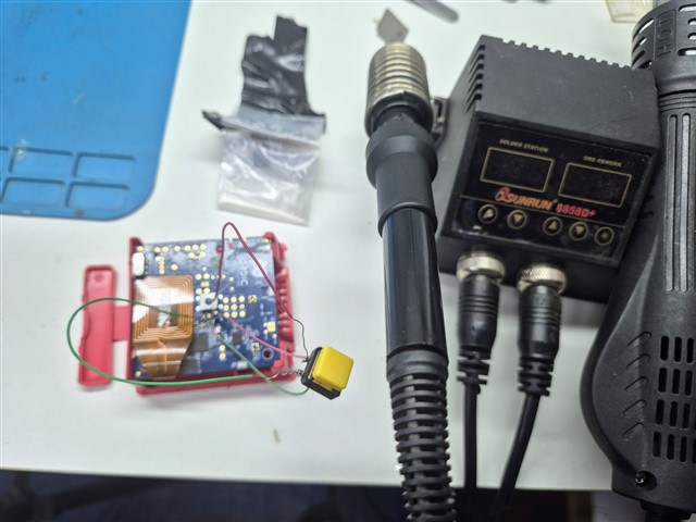

thingy:53 I have damage to the sw2 pin and I am unable to enter the DFU
I have thingy:53 and I have damage to the sw2 pin and I am unable to enter the DFU. I lost two tiny pieces that go just above the one in the photo and not even using a needle, it seems to me that the button (which was not working before) now doesn't work anymore
My question is: What would be another way in the circuit to put sw2 under pressure (while I throw sw1 to ON) other than pressing this "button"
I stay trying this: https://academy.nordicsemi.com/flash-instructions-for-the-thingy53/  (USB-C Mode)
Note01: I still have the two tiny pieces that came off the top of the sw2, but I don't know how to solder them back and I don't even know if that would solve the problem.
