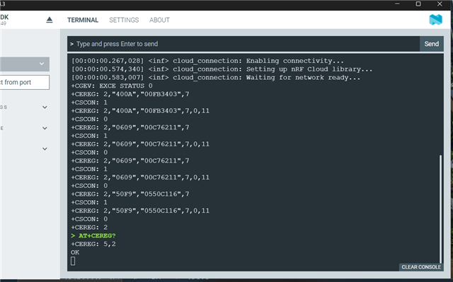

how to add softsim to an existing project like nrf_cloud_multi_service
We recently managed to get the onomondo softsim working on a dev kit, we used the sample code provided by onomodo to do this. Now we want to add the softsim to the nrf_cloud_multi_service sample. What are the changes that we need to make on this sample inorder for it to work with a softsim.

    while trying to build using west build -b nrf9151dk_nrf9151_ns -- "-DOVERLAY_CONFIG=C:\ncs\v2.6.2\modules\lib\onomondo-softsim/overlay-softsim.conf"
  • The sample build successfully when I made this changes in the prj.conf

    And then I flashed this firmware onto a device in which a soft sim was already provisioned and this is what I see in the terminal.
    The program doesn't go beyond this point as the device can't register with the network.
    When I ran the AT command to check the network registration status, I'm getting +CEREG: 5,2 as response.
    PS: The sdk version I'm using 2.6.2
    Can you specify only the changes which you made to the prj.conf?
    Updating only Kconfig options in prj.conf might not be enough to integrate Onomondo SoftSim with the multi service sample. Additional steps might be needed. I will check this internally and get back to you during next week.
