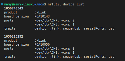

    Have you tried restarting VS Code and the computer?
    Can you check if nrfutil can find the device? You can do so by opening an nRF Connect terminal in VS Code and using the command "nrfutil device list". The connected devices should show up like this:
    Marte
  • Hi Marte,
    checked nrfprog to check finding DVK. Is ok.
    using nrfutil seems to fail.
    Downloaded latest version from nrfutil and tried that with the same result.
    Georg

  • Hi Marte,
    think I got it. I reinstalled nrfutil device and then the list is shown without error.
    Then the sdk is shown under connected devices.
    Thank you for the tip with nrfutil device list.
