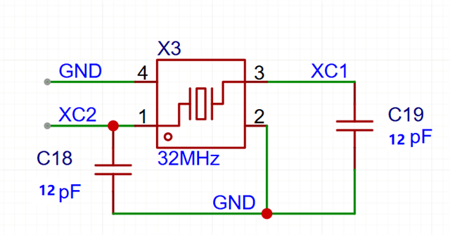

Can you share your schematics and datasheet and full part number of the crystals that you're using?

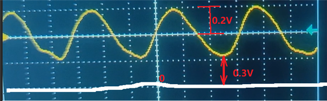

this is the wave from xtal . you can see the peak to peak value is 0.4v
I donnot know where this is ok. but the nrf52833 would always use internal xo.
unfortunately, I cannot get the wave from nrf52833 DK.
would you please tell me where the amplitude is ok. and is it necessary to improve the wave amplitude?
thanks. a lot
I have another board with tcxo (use xc1 ), the peak to peak value is 0.8v. the nrf52833 would always use internal xo too.
and what requirement is need to enable the external xtal for nrf52833. thanks.
I can not determine if the crystal is functioning based on that plot.

the datasheet is:
thanks for your help..
the xtal signal is like:
the voltage range from 0.3v to 0.7v
would it be ok?
would you please show the signal in DK? I cannot get the xtal signal from DK.
