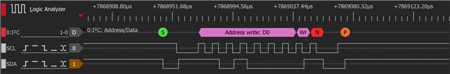

I grabbed my logic analyzer and noticed the following on the I2C bus:
even though the address is specified to be 0x68 in the '.overlay' file, the actual address sent is '0xD0' where
0xD0 = 0x68 << 1;
I don't know. Is it a bug, or am I doing something wrong?
