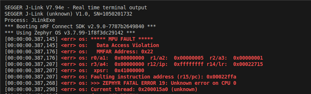

  • Hi Kazi,
    Tried your code.
    devicetree error:
    nrf52840dk_nrf52840.overlay:37 (column 29): parse error: expected number or parenthesized expression
    That is cause by "pixel-format = <PANEL_PIXEL_FORMAT_RGB_565>;"
    If I remove that line and recompile
    C:/Users/BjornOlsen/Documents/GitHub/nestlab/build/zephyr/include/generated/devicetree_generated.h:15794:50: error: 'DT_N_S_mipi_dbi_S_gc9a01_0_P_width' undeclared here (not in a function); did you mean 'DT_N_S_mipi_dbi_S_gc9a01_0_P_reg'?
    15794 | #define DT_CHOSEN_zephyr_display DT_N_S_mipi_dbi_S_gc9a01_0
    so now it seems to complain about width.
    I feel I am getting closer, but not quite there yet.
    For the first error, it seems the PANEL_ was not defined. It should be in the devicetree file as header file
    #include <zephyr/dt-bindings/display/panel.h>
    Can you try this first and see if you get the second error?
