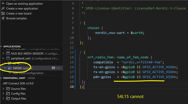

nRF54L15 DK cannot work with nRF21540 EK

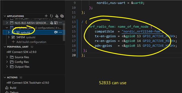

I am using nRF54L15 DK and nRF21540 EK together. I am using the GPIO FEM mode. Below is my projconfig:

I notice that I cannot use 21540 EK in 54L15, the overlay I am using is:
	nrf_radio_fem: name_of_fem_node {
	   compatible  = "nordic,nrf21540-fem";
	   tx-en-gpios = <&gpio2 9 GPIO_ACTIVE_HIGH>;
	   rx-en-gpios = <&gpio1 10 GPIO_ACTIVE_HIGH>;
	   pdn-gpios   = <&gpio2 7 GPIO_ACTIVE_HIGH>;
However, when I am using nRF52833 with this overlay
The FEM works well
What is happening in 54L15 DK, could you help me to fugure out?
