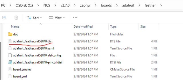

I have an Adafruit feather nRF52840, and try to program it via a Nordic DK (through the connector Debug out). It is possible to flash the feather when I use a devicetree file for a DK, for instance nRF52840DK with 52840. If I instead use the dts-file for the feather, I get this error:
I have tried to program both from a 52840DK and a 52DK, with the same result. Is there something missing in the feather dts-file? Or something else?

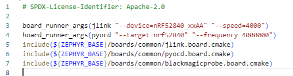

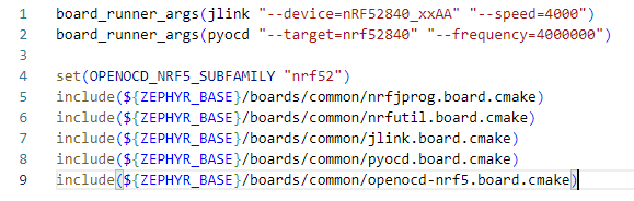

    I have now made my own board instead of using the Adafruit dts-file. I made a simple LED-blinking program, and it works fine. I followed your lesson on DevAcademy, and came across the file board.cmake. The one that was generated for my board is different from the one in the Adafruit folder. My board.cmake looks like this:
    The one in the Adafruit folder looks like this:
    So I just replaced this content with the content in my file. And now this also works. I know one shouldn’t adjust things in the SDK, I just did this for test purpose. But it feels strange that it is not possible to use the original file. Should one flash the board in another way than I do? Or why is it like this?
